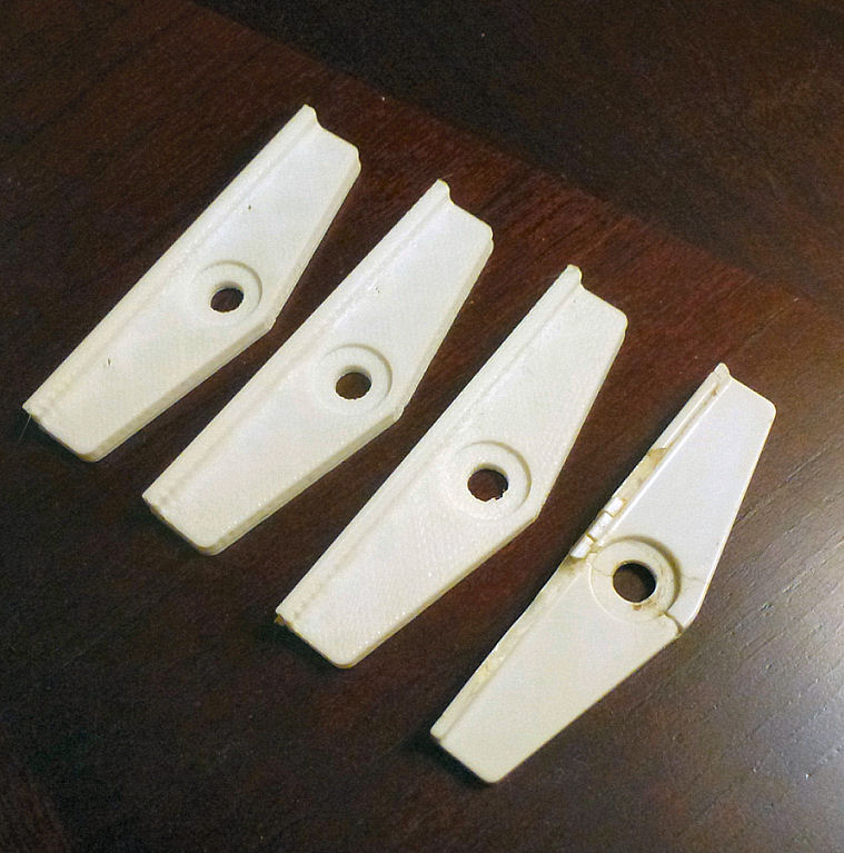

Since I moved last year I haven't done a lot of 3D printing, mostly practical stuff like replacing broken washing machine parts. The washer was starting to sound louder than a jet taking off so I spent a day replacing the bearings, some little spacers and stuff that were old cracked up plastic had to be replaced as well and I wasn't going to pay 5 bucks a pop for a few cents of plastic to keep the door from rattling.

The things for the washer and dryer doors:
